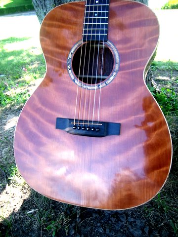

Well I am about finished with this build. Posted some pics of progress some time ago and thought I would post a few of the finished pictures
Nice redwood top. When I first got her all assembled and played (prior to finish) I thought "Man, what a dog this thing is" - the sound to me was horrible, no volume, no treble - it was just plain bad - or so I thought.
Anyway, I went ahead and finished. Have roughly 8 coats of lacquer - 4 in one shooting, set for a couple weeks, sanded with 600, applied another 4 coats, let sit for a few days and then sanded and polished.
The redwood is stunning - although my patience level still has a ways to go. I should have drop filled some of the divits and areas where the binding meets but so anxious to finish that I went right to sand and polish - so I do have a few minor finish flaws. Maybe someday I will play with them some more.

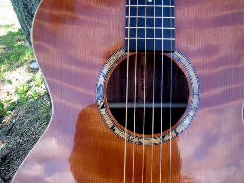

Really pleased with the Spalted Maple Rosette

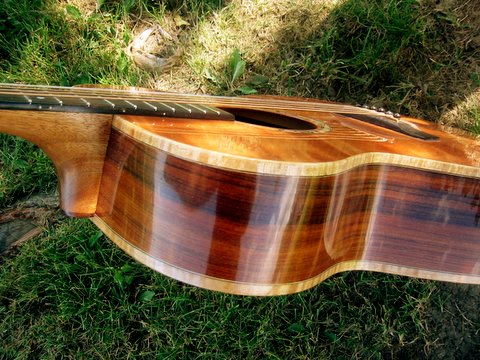

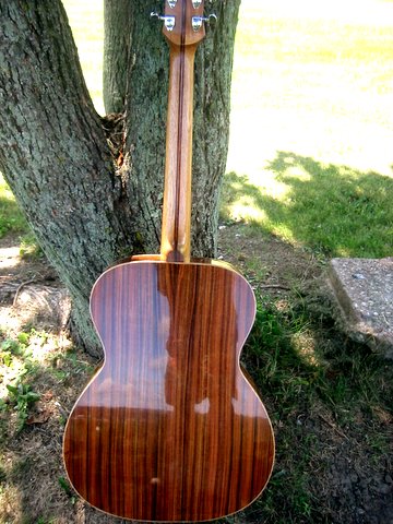

Pau Ferro back/sides with Maple bindings.
Not sure if you can see it, but still have some trouble with inlay showing edges where routing is a little off. I mix eblny dust with Titebond and then for the smallest divits, filled with a little CA. I dont know what I am doing wrong because I have done this in the past and the outline of the inlay was really invisible. Now I can see where I filled.

Rich, beautiful guitar, the top is stunning, and the color of the nut blends well with the entire scheem. One thing though,, we need more pics, especially a full shot of the top/neck/head.. stop teasing us
PostPosted: Tue Aug 08, 2006 11:29 am
Rich -- whoa it looks great! Nice combo of sides/binding/top and killer rosette!
About the ebony filling I am wondering if it was the combo of dust and titebond that is causing less than desired results. I fill all of mine with dust/CA now and am not particularly careful about which part of the board the dust came from and pretty happy with the results.
Nice job sir -- if its anything like the maple dread I played at Bob's I'll bet its a winner.

Fantastic guitar, Rich! That's some killer redwood. Terrific looking rosette as well. Can't wait to play that one at the next gathering.

Rich, i'm in love with that one too!
I'm sure the sound will get better and better by the hour my friend! Way to go!

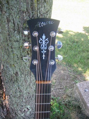

Love that laminated neck, rosette and your headstock design! More pics Pleeeeeeaaaaaaase!!!!!!!
From what i see here bud, you really did wait and finished it well, remember those 25 other guitars that need being finished, i'm watching you!
Great looking top!

Rich that's a real beauty my friend. The maple guitar sounded great too. Try using fine ebony dust and fill the cavities high then flood with ca.

Great looking guitar Rich. Leave out the titebond and just fill with ebony dust and CA. It'll be much better. Just fill with dust and then flood CA. But don't use any excellerator.

   I've tried CA and dust, PVA and dust and epoxy and dust. To me the epoxy gives the most invisible fill.

Ron, I've found epoxy leaves a visible shiny line that can be a slightly different shade.

The finish is glass-like which really pulls the grain tones front and forward in the redwood.

I will be practicing with some ebony and different methods to see how they work out. I did try dust and CA in the past but my AAA personality applied activator because I didnt want to wait for cure. It left white spots and I know why!!!!

What a beautiful guitar...I love the matching neck stripe with the guitar's back wood...really classy.
